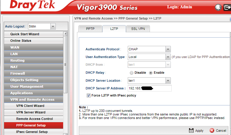

Just to say that this was actually an IP issue - our DrayTek was not performing DHCP and this was the issue - I configured the DHCP relay under LAN > General Setup > DHCP Relay to no avail BUT under VPN and Remote Access > PPP General Setup > L2TP I configured the following:
